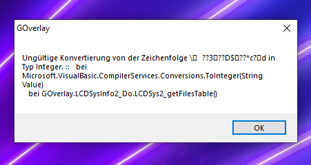

Postby Horni xxx » Sat Jan 11, 2025 9:46 pm
Hi,
Can someone tell me where I can download a firmware update?
I think my firmware is defective. I get an error message, see picture

Postby TheLaGmAn » Sat Jan 25, 2025 3:52 pm
Your device filetable is corrupt, do not update the firmware, just go to tools and restore to defaults
