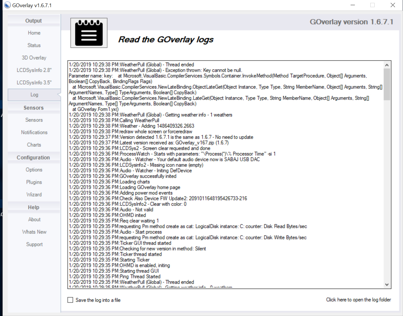

The log file shows:
1/20/2019 3:31:59 PM:WeatherPull (Global) - Getting weather info - 0 weathers
1/20/2019 3:31:59 PM:WeatherPull (Global) - Thread ended
My log file is attached.

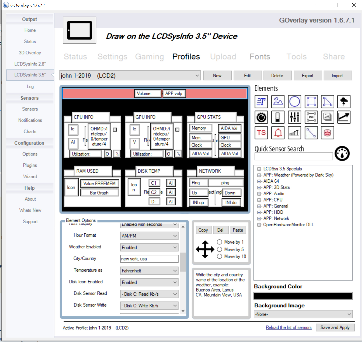

"new york, usa" for example will work.
you are using only lcdsysinfo 2.8?
Where is the weather set up? in the notification box or where?
Hit save on your profile and grab all the contents of the log window of goverlay and attach them here

Postby tedharris600 » Mon Jan 21, 2019 3:16 am
Hello,
I am using the 3.5" LCDsysinfo only.
I am trying to use the built in weather sensor that is in the "notification box" as shown below.
I just realized that I can manually add a weather sensor from "Dark Sky". That seems to work for the temperature and weather condition as text, but I don't know how to set up the weather condition icons (cloudy, rainy, etc.) that were present in the "notification box".
Here is the log file:

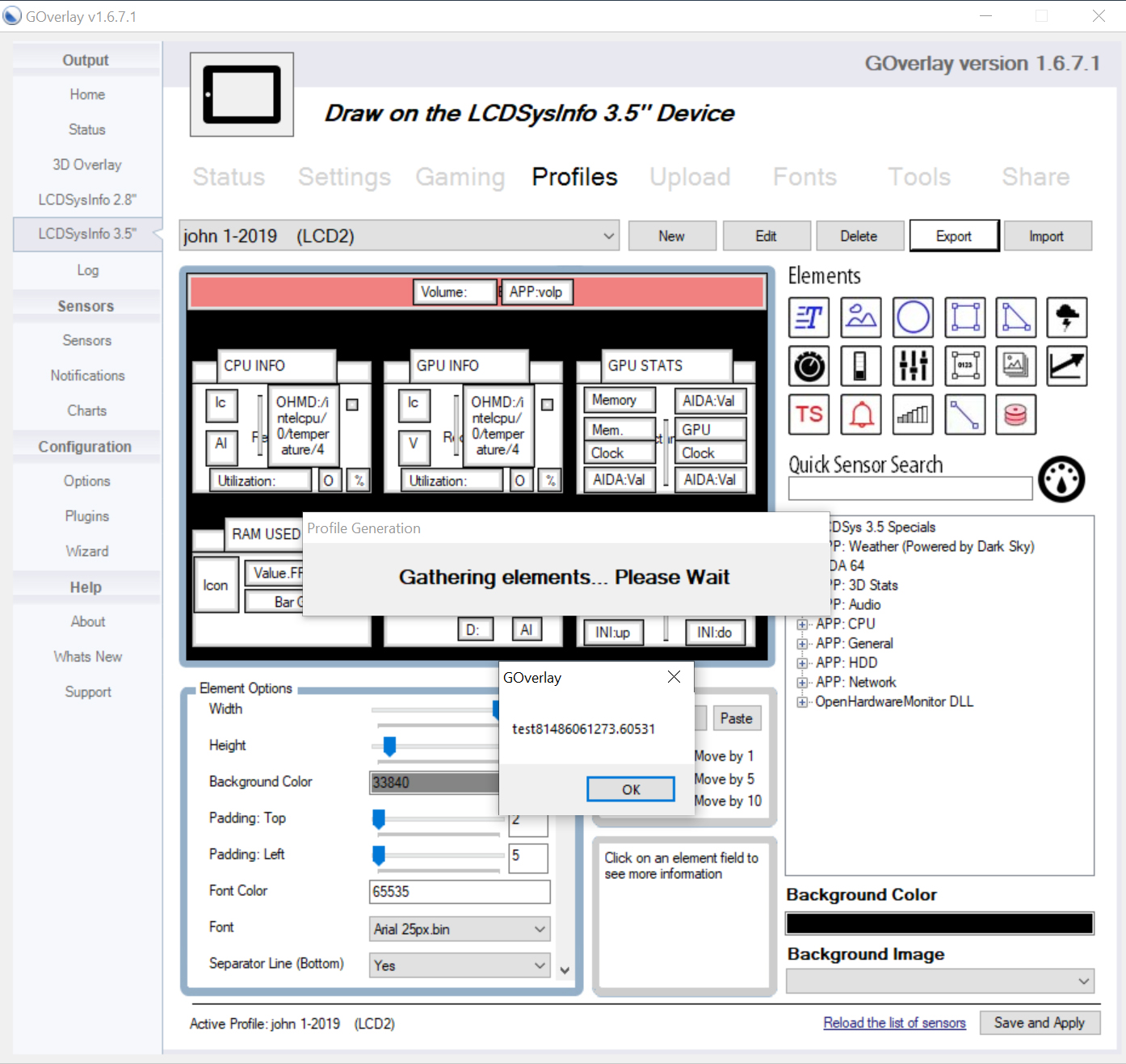

Postby tedharris600 » Mon Jan 21, 2019 6:57 am
Hello,
I have just discovered that I cannot export my profiles in this beta. I get the screen below.
I have to keep clicking through several dialog boxes that have the word "test" in them. The dialog boxes never seem to end. I finally have to kill GOverlay in task manager.
I am running Windows 10 Pro 64 bit version 1809 build 17763.253.
Thank you.
tedharris600
Posts: 36
Joined: Fri Mar 14, 2014 1:32 pm
Re: GOverlay BETA 1.6.7.1
Postby TheLaGmAn » Mon Jan 21, 2019 1:25 pm
the export is a bug on this beta, download the 1.6.7.2 (its posted in the forum now).

Please create a new profile (notification box), set only the weather to it and hit save, wait 5 seconds after it shows in the display and then, go to the logs tab and copy all the contents of it and add them here
