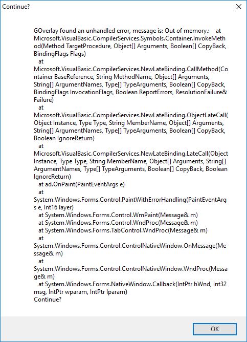

Postby SubSonix » Tue Feb 07, 2017 5:39 am
I use HWINFO too so it could indeed be the cause. But I haven't been able to keep an eye on things as I'm currently moving.
I'll try and help out some more once I'm settled into my new place :)
SubSonix
Posts: 82
Joined: Sun Nov 30, 2014 5:23 pm
Re: Memory leak
Postby TheLaGmAn » Tue Feb 07, 2017 3:49 pm
Could you try this plugin dll? Replace the old one (Close GOverlay first).
HWInfo_Plugin.zip
(7.6 KiB) Downloaded 1835 times
Re: Memory leak
Postby walt » Tue Feb 07, 2017 5:06 pm
TheLaGmAn wrote:i will take a look on the plugin.
Can you list me the sensors you are using from it?
how do i do that? Is there a logfile i could provide to you?
I will also try that plugin you have uploaded.
*update*
The plugin you have uplaoded doesn't show up in the program. It's not listed under the plugin section.
walt
Posts: 14
Joined: Sun Jul 26, 2015 11:26 am
Re: Memory leak
Postby TheLaGmAn » Tue Feb 07, 2017 5:21 pm
Since its in a zip, try to right click on the unzipped HWInfo.dll and click properties.
See if the file is blocked.
Re: Memory leak
Postby walt » Tue Feb 07, 2017 10:14 pm
great. now it seems to work properly.
I will report back after some testing, if goverlay starts eating ram again.
walt
Posts: 14
Re: Memory leak
Postby TheLaGmAn » Wed Feb 08, 2017 5:08 pm
perfect, let me know how it goes in a day or two
Re: Memory leak
Postby walt » Thu Feb 09, 2017 8:40 pm
It works, no crashes or memory leaking.
Thanks TheLaGmAn
walt
Posts: 14
Re: Memory leak
Postby SubSonix » Mon Feb 13, 2017 6:07 pm
I'm still getting a memory leak. And I've updated to 1.4.8.
I've got a feeling it only does it in gaming mode, but I'm only guessing currently.
I was gaming just now and checked it's memory use and it was up to around 1.3/1.4gb and then this happened. (see image)
I'm still in the process of finalising my house move so I will follow up on this soon, but can't right at this moment.
What would you suggest is a normal amount of memory use?
This is my "gaming" profile, I believe you can find the sensors I use in here?

Postby TheLaGmAn » Tue Feb 14, 2017 1:02 am
can you try disabling all your volume sensors? i think that might be the issue (you have them on your gaming profile, check if you also have it in your windows profile).
Disable them and then restart goverlay
About normal memory usage, GOverlay uses between 50 and 90mb aprox.
Re: Memory leak
Postby SubSonix » Tue Feb 14, 2017 7:27 am
TheLaGmAn wrote:can you try disabling all your volume sensors? i think that might be the issue (you have them on your gaming profile, check if you also have it in your windows profile).
Done on both (they're basically the same so easy to test), I'll report back when I can :)
