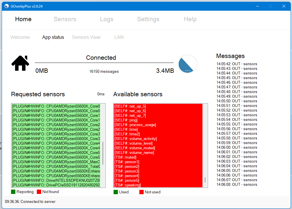

Postby Clone003 » Sun Jun 02, 2024 6:19 pm
It happened again. This time all of the sensors aren't updating.
I restarted GOverlayPlus after saving logs and screenshots, and it started working fine. The HWinfo plugin exceptions didn't appear this time.
Is there a way for Goverlay to automatically save to log file on startup?
Maybe even save it every 5 mins instead of continuously?
I believe all the SocketServer info messages cleared the oldest messages, since I did not notice the bug until hours after I booted my pc up.
Anyways, I pasted the exception messages, which didn't get cleared.
App status tab showed HWinfo sensors (in screenshot below), but I did not see any sensors in the 'Sensors View' tab
Exceptions:

Postby TheLaGmAn » Sun Jun 02, 2024 8:17 pm
try the beta
Hidden Message:
and create a file named "save_logs.txt" in the goverlay folder, that way it should auto-start with the save log by default
